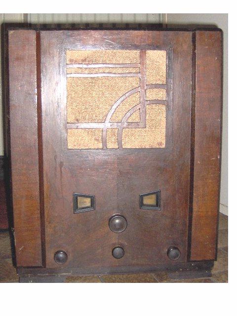

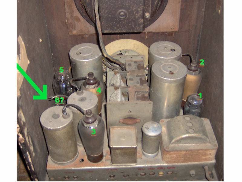

Qui conneu mon radio?
Ondia 53 c ést trop indentique, mais avec 5 lampe
Mon radio c ést avec 6 lampe.
Who can help me to identify this radio ?
It looks verry simmular to an Ondia 53 but the Ondia 53 has 5 tubes
This radio has 6 tubes.
I do not have any idea

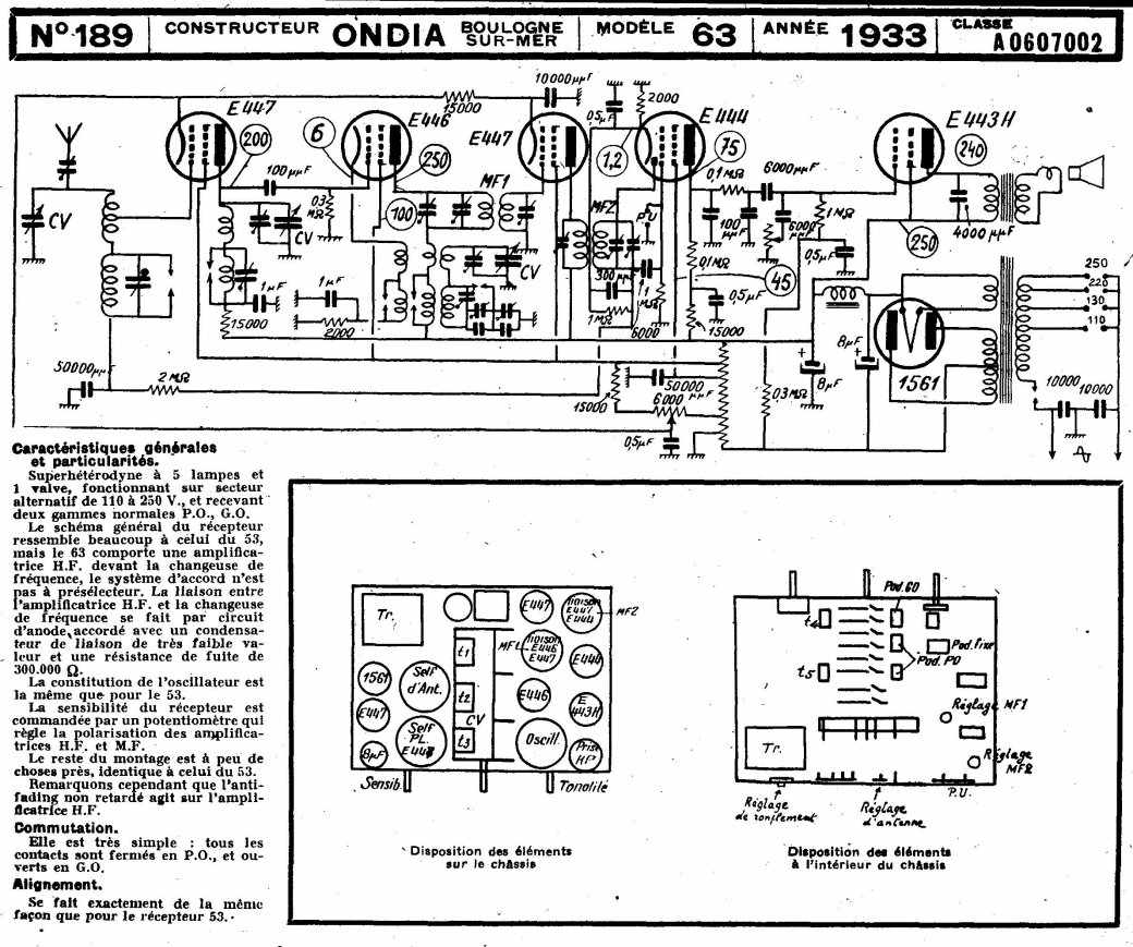

A picture of this receiver or a schematic will perhaps help us to recognize it.

Cést un Ondia 63, mercie votre responce
I have had allready the answer:
It is a Ondia 63.
Schematic would be welcome.
Sujet : identificer le radio Nouveau | De Jpg Le 29-06-2008 à 21:04 sta |
Schematic Ondia 63.
