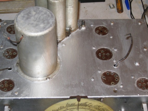

| Sujet : l g m radio Nouveau | De fred Le 14-02-2012 à 20:59 sta |
hello french radio collectors the tubes i need are pin tubes the same model are used i n a frech philips 640a the plugs are some whit 4 holes . some whit 5 and there is one whit 6 holes the problem is what combination do i need
| Sujet : l g m radio Nouveau | De wizhard Le 14-02-2012 à 21:24 sta |
Hello...
Those tubes are called "american support" and are almost often used on sets of this era.
personnally i don't know, but some other people on the forum maybe.
With this indication i think the tube outfit may be retrieved. the difficulty may be their placement, but fortunately those tubes have different pinouts, with or without grid caps, and well separated functions. The problem should be worther with Octals, for instance, as all tubes uses the same plug. I translate.
However those tubes are quite rares....
Apparemment son poste a 7 supports type américain .en 4, 5 et 6 broches. si quelqu'un connait la série classique.....Il dit que ce sont les mêmes sur le 640 a mais je ne sais pas s'il a voulu parler des mêmes tubes (ou supports) ou de la même série.

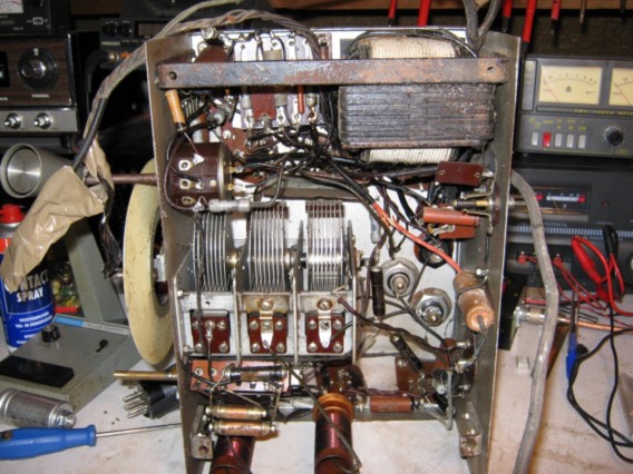

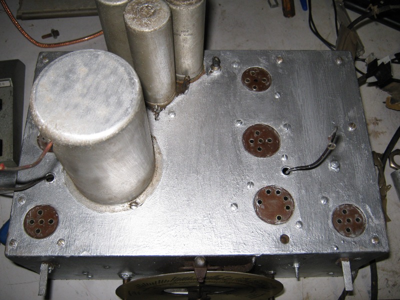

| Sujet : l g m radio Nouveau | De fred Le 15-02-2012 à 22:00 sta |
hello foto,s du chasis hello radio collectors i dont know if this is correct but i hope somebody can see on the pictures what i mean![[:Hi:]](s12.gif)
| Sujet : l g m radio Nouveau | De wizhard Le 16-02-2012 à 11:07 sta |
Fred m'a envoyé d'autre photos, sur une on voit bien tous les supports.mais il faut que je la redimensionne.
Fred send me other pictures, on one we can see all plugs. but i must resize 'em.

| Sujet : l g m radio Nouveau | De Totolagalène Le 16-02-2012 à 22:14 sta |
Hello Fred!
Although we don't see any power supply transformer on your picture, is there one under the frame? ![[:Hi:]](s12.gif)

Si vous voulez on va proceder par etapes.
1er etape
D'abord en ohmmètre repérer les filaments, cela élimine 2 broches par tube.
La chaine filament est elle retournée a la masse directement ou par une résistance ?
S'il y a une résistance quelle valeur ? si oui il y a sans doute un BF finale a chauffage direct
Reperer son support en general la resistanse est proche.
Si on ne la repere pas ainsi on verra comment la trouver après.
Faites cette manip la suite au prochain N°
Amicalement
Radiolo
| Sujet : l g m radio Nouveau | De Totolagalène Le 17-02-2012 à 18:53 sta |
Pour les filaments pas de problème, vu qu'il y a un transfo sous le châssis c'est tout du 4 V.
(Déjà pas un "Tous courants"). Ces tubes existent en "Tous courants".
Le socket à 4 trous est la redresseuse, une 506.
Celle à 6 trous en cercle est sûrement une E444 (D-BF) si le fil sortant du châssis va dessus, sinon une E463.
Le tube de puissance, si ce n'est cette E463, est une C443, C453 ou E443 (même brochage à 5 trous=.
Pour les autres tubes il faudrait savoir si c'est un montage à amplification directe, je le pense car on ne voît pas 2 TR(s) MF. ![[:Hi:]](s12.gif)
| Sujet : l g m radio Nouveau | De Totolagalène Le 17-02-2012 à 18:59 sta |
L'autre photo de Fred >>>>>>>>>>>>>>>>>>>>>>>>>>>>>>>>>>>>>>>>
| Sujet : l g m radio Nouveau | De radiolo Le 17-02-2012 à 19:01 sta |
Oui cela ressemble a une amplification directe
Apparemment la messe est dite.....
Y a plus qu'a essayer
Mettre sous tension le transfo.
Changer les 2 chimiques HT.
Mettre en place la valve
mesurer la HT obtenue, attention cela va monter haut peut etre plus de 400V, prévoir les capas en conséquence.
Après la BF, l'excitation HP, le transfo de sortie et il émettra ses premiers sons.
Amicalement
Rémy
| Sujet : l g m radio Nouveau | De Totolagalène Le 17-02-2012 à 22:10 sta |
Je crois que Fred a réglé son problème:
Quelquechose comme:
Sur la rangée de gauche: E462, E428, E462
A droite : E444, E443 et redresseuse 1561 plutôt que 506 (500 V 120 mA contre 300V
90 mA). C'est de l'amplification directe. ![[:Hi:]](s12.gif)
